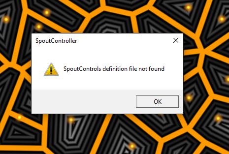

The SpoutController didn't work and displayed this message:

Yes the SpoutController isn't working properly. It's looking for a control file because I forgot to create the controls in the first place within the plugin. It works for me because the file already exists.
I am trying different things at the moment and  I will think about it. Meanwhile it isn't important and won't affect the plugin binary.
